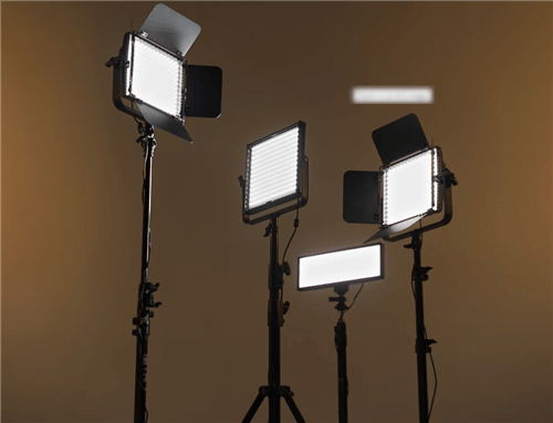

What is White Balance?
Before we delve into the how-to, let’s first understand what white balance is and why it’s essential. White balance is the camera’s ability to adjust its color temperature settings to accommodate different lighting conditions. Each light source’s color temperature is measured in Kelvin (K). For example, daylight has a color temperature of around 5600K, while tungsten bulbs have a lower color temperature of about 3200K.
When you set your camera’s white balance, tell it what color temperature the light source is so it can adjust the colors accordingly. If the white balance is set incorrectly, your footage may have a color cast, such as a blue tint in daylight or an orange tint under tungsten light.

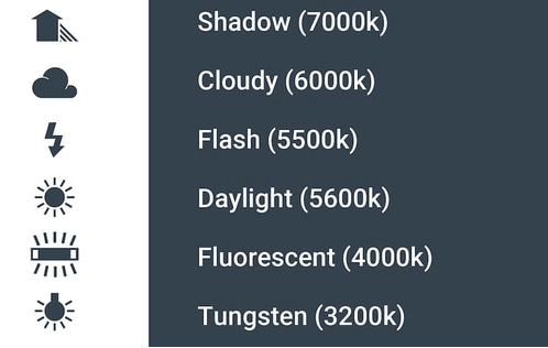

Types of White Balance Settings
Most cameras offer three main types of white balance settings:
  1. Auto White Balance (AWB): In this mode, the camera automatically detects the scene’s color temperature and adjusts the white balance accordingly. While AWB can be convenient, it’s only sometimes accurate, especially in mixed lighting conditions.
  2. Preset White Balance: Most cameras have preset white balance options for everyday lighting situations, such as daylight, cloudy, tungsten, fluorescent, and flash. These presets are pre-calibrated for specific color temperatures and can be a good starting point for getting accurate colors.
  3. Custom White Balance: For the most accurate white balance, you can use a white balance card or gray card to manually set the white balance. This involves taking a reference photo of the card under the current lighting conditions and using it to set the custom white balance in your camera.

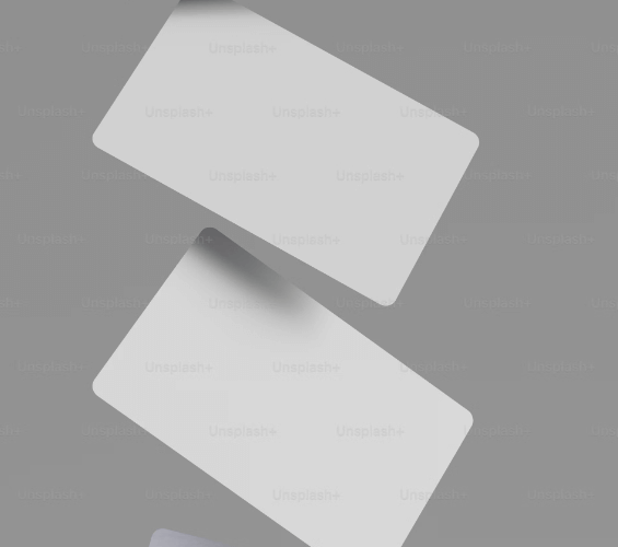

Using White Balance Cards
White balance cards, also known as gray cards, are essential for achieving accurate white balance. These cards are designed to reflect light evenly across the visible spectrum, providing a neutral reference point for setting your white balance.
White Balance Card
White Balance Cards
To use a white balance card:
  1. Hold it before your camera and fill the frame with the card.
  2. Make sure the card is evenly lit and not in shadow.
  3. Please take a photo of the card and use it to set your camera’s custom white balance.
Most cameras have a custom white balance option in the menu, which allows you to use a reference photo to set the white balance.
