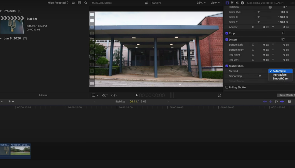

Auto-Stabilization
The default stabilization method in Final Cut Pro is Automatic, which will choose a stabilization method for you. However, you can further refine the stabilization settings or even change the stabilization method entirely to achieve the best results for your specific footage.
Auto-Stabilization
Auto-Stabilization

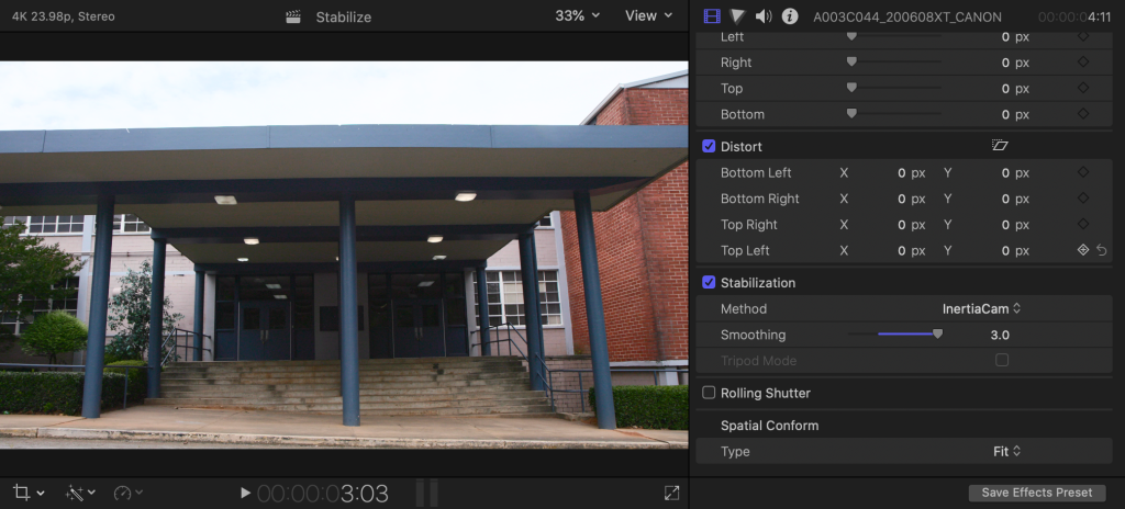

InertiaCam
When to use: If your clip features camera movement such as panning or zooming, you should choose the InertiaCam stabilization method.
How it works: InertiaCam stabilizes the footage according to the camera’s dominant motion, preserving the intended camera movement while reducing unwanted shake.
Adjusting settings: You can control the amount of stabilization by adjusting the Smoothing amount. A higher value will result in smoother footage but may introduce some cropping. Lowering the value will preserve more of the original footage but may not eliminate all the shake.
Tripod Mode: If your camera is stationary, you can select the Tripod Mode option to further improve the stabilization results.

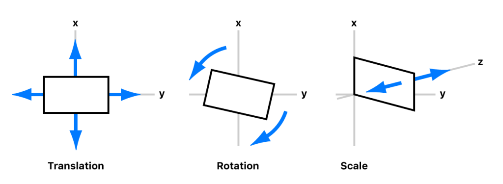

SmoothCam
When to use: If your clip does not feature intentional camera movement, then SmoothCam is the ideal choice.
How it works: SmoothCam stabilizes Translation (position), Rotation, and Scaling (zoom) independently, allowing for finer control over the stabilization process.
Adjusting settings: With SmoothCam, you can individually adjust the Translation Smooth, Rotation Smooth, and Scale Smooth parameters. Experiment with these settings to find the right balance between stability and preserving the original footage.
